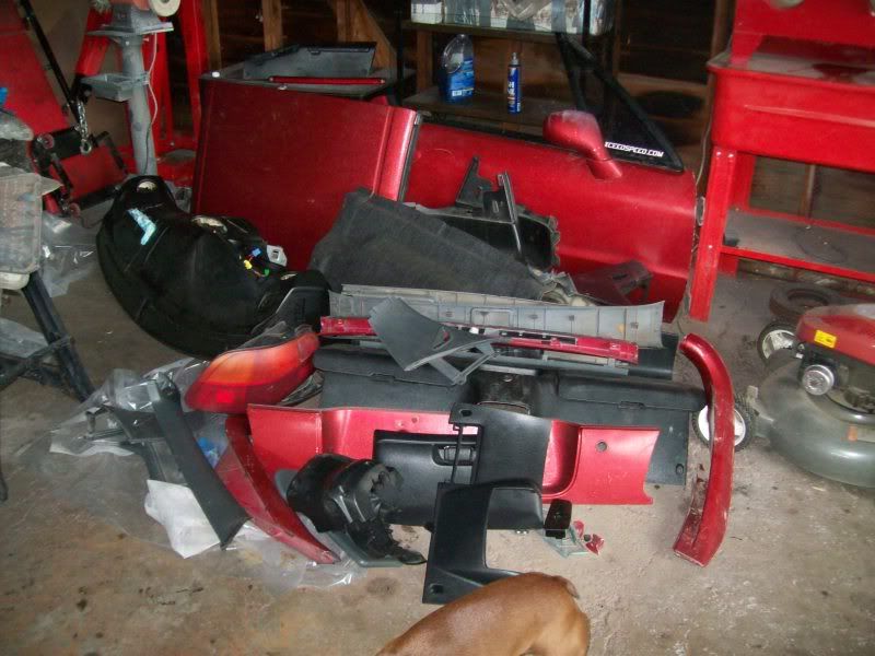

buddy of mine hooked me up with one of his friends who recently wrecked his sol. He was nice enough to let me pick tru the wreckage before he had the shell halled off. I ended up with a door, targa top, tail panel, tailights, cowling around the rear window and almost the entire intirror.... can any one say carbon wrap?

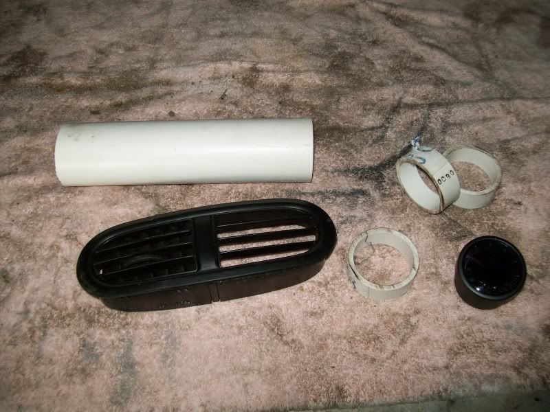

so i took the extra center airvent i snagged and got to work..

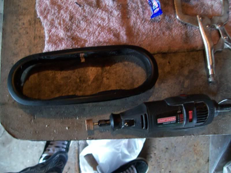

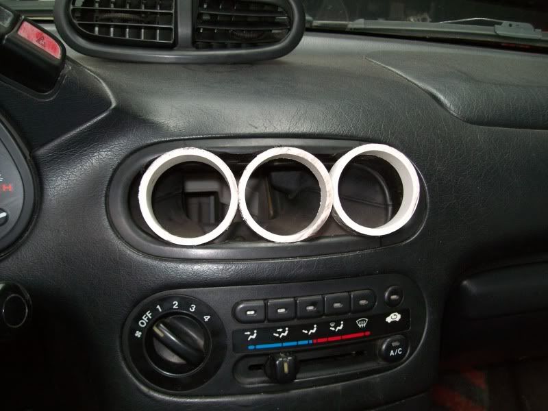

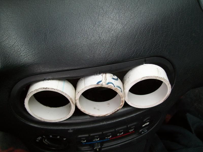

started off by picking up some pvc that the guage slid into snugly, and cutting out three chunks about 2 inches long
i then took my rotery tool and got to work cutting out the heater vent bits and grinding out a little bit of the eges to clearence for the rings.

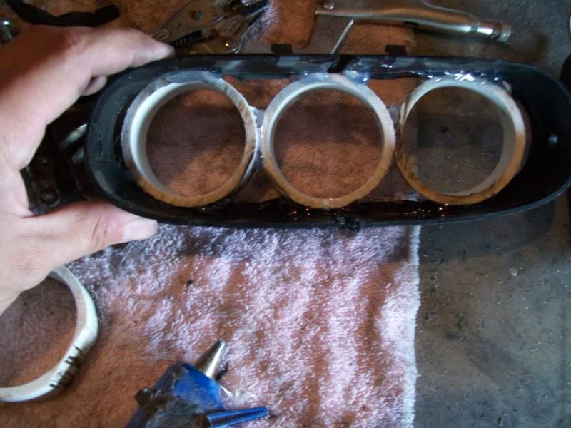

I then popped the remains of the heater vent into place, positioned and carefully superglued the rings in place
i then popped it out and stold my hot glue gun back from my wife! and started re-inforcing the rings

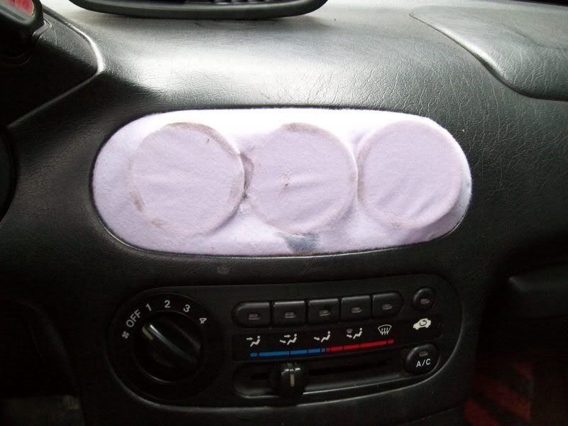

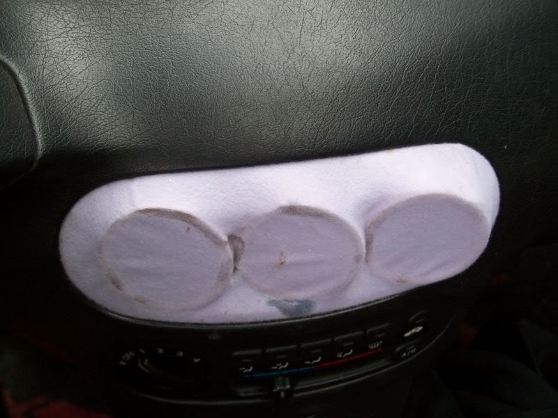

i then wrapped some light thickness fleace fabric over the face and the rings, hotgluing the face of the rings and wrapped around and glued it along the back side of the heater vent lip... I must stress this, the more gay the fabric you buy the better your results will be, also you want to buy absorbent fabric that stretches alot!
when your hot-gluing make sure to take your time to stretch all the wrinkles out that you can... this will save you work down the road in the finishing stages...
i then trimmed the excess fabric away and test-fitted it to make sure i liked the contours of it.
it looked good to me, so using some automotive repir fiberglass resin i wetted down the flece and built up excess in any low spots to make the smoothing process a little easier.
once the resen has cured ill flip it over, and lay some chop cloth on the back side...
then smooth it out with some filler, and paint it flat black for now...

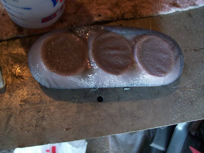

the facad layer was hardened so i flipped it over and stuffed scrap chop matt in ever nook and cranny i could and soaked it in resin, making sure not to get any on the inside of the pvc rings.

i got the first sanding (with 150 grit) done, got some thick sandable primer on it..

test fitted the pod, very snug but looks great.
i touched up the little spots still left with some glazing putty. tomorrow i will sand it down, and shoot some semi-gloss black on it and call it good for now...
