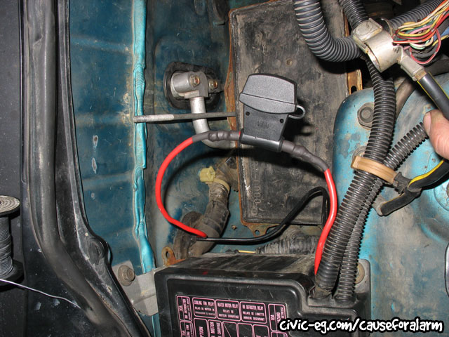

The pics above were actually from a previous project. There was no need to do that on this car since I planned to completely rewire the stereo with aftermarket wire and forgo the stock stereo harness altogether.With any car that I plan on having for a long period of time, I run new heavy gauge power and ground wires directly to the battery, and then I run new heavy gauge speaker wire into the front doors*. I remove the rear speakers to decrease weight, save cost, free up wattage for the front speakers, and to improve staging.
*Running wires into the doors is a huge PITA. Make the most of it and run actuator and potential future tweeter wiring, or leave the stock stereo wires to reuse for tweeters since they don't require heavy gauge wiring.
The only factory wire left over would be the accessory power wire, which I run straight to the under dash fuse box to avoid needing the stock stereo harness at all.
