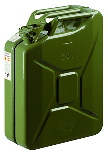

put one of these in the roof basket
and one of these
and a spare tire lol
By Leppy
#359371 That's exactly what I had planned! Gonna search for a lower profile 5l jerry can and an ammo box and mount them towards the back of the rack on each side.
