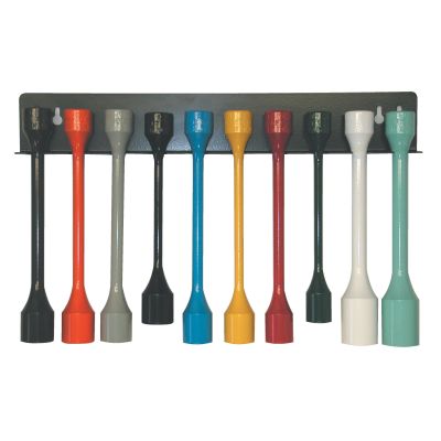

80 lb ft torque is good enough. if it was super tite slap your mechanic. make shure they dont tighten it down with a air impact. unless they use torque sticks
usualy the blue ones ate 80lb ft torque for a 19mm lug.
