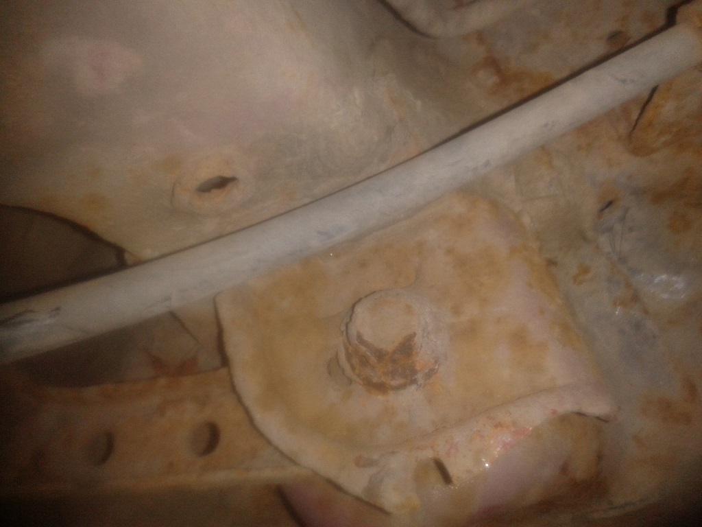

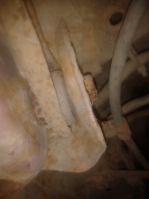

#358802 Man I wish I could be as optimistic as you. Here are some pics that will show you why I'm afraid to remove stuff. If some of these bolts break, I do not have time and replacement parts. I'll leave the conversion for another time when I will also do the whole undercarriage which clearly needs attention.

#358804 You'll need to buy about four cans or so .. I would apply one can to each side of the trailer arm. Every where you are going to remove a bolt, SPRAY !!!!!
Remember , when you spray , you must let sit for a couple of minute to let penetrate into the thread area. Also, You must first, tighten more the bolt then loosen. This make sure when you remove the bolt, it is well lube to come out and not tend to break on you. Third thing, make sure you are not using a impact tool... All by hand brother.
No pain no gain.
Best of luck. Let us know how it goes.
#358807 When PB doesn't cut it, get out the propane torch and heat the bolt up. The heat will expand/contract the bolt and break the rust loose. If you get some turns and then it starts to get difficult, tighten back up and repeat the PB blaster and/or heat process and try again. Being impatient can result in a snapped bolt. I'm in Ohio, I can tell you all about it lol.

The best key words, BE PATIENT !
