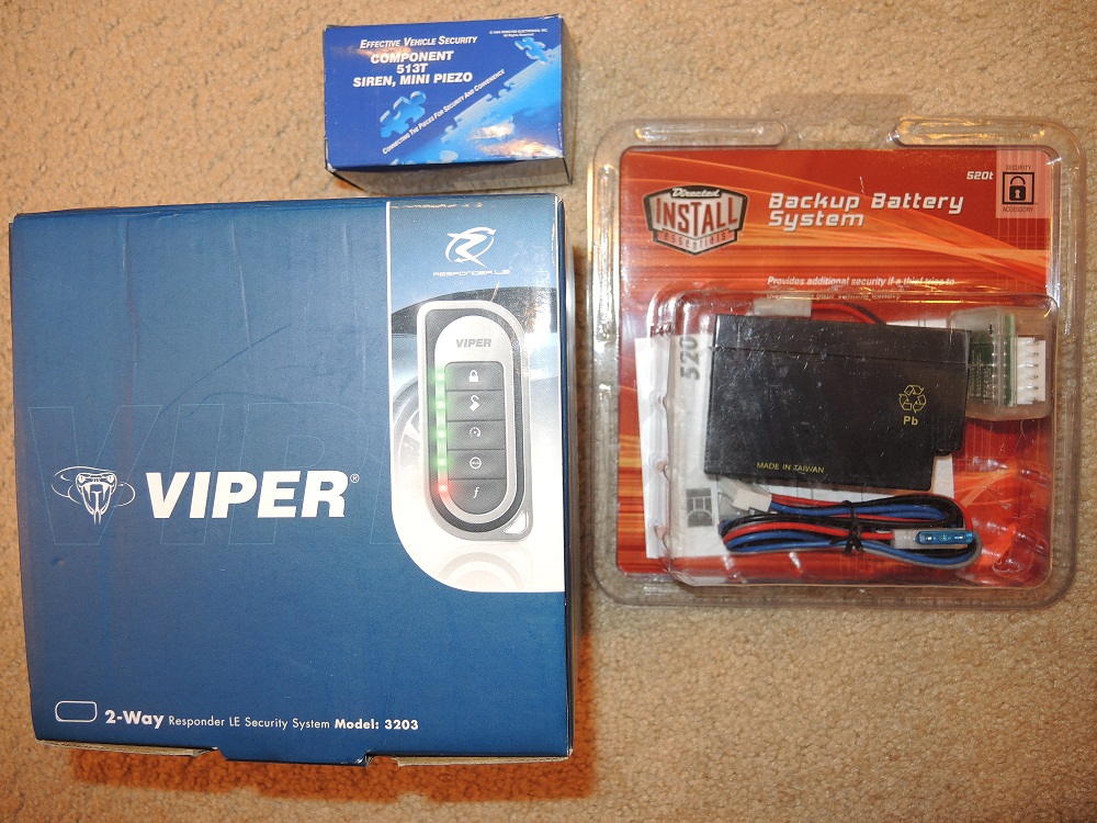

The car I'm installing alarm in is a 1999 civic LX (factory power door locks), Manual transmission (no remote start needed)
What I've bought so far:
    viper 3203 kit
    Backup Battery System 520t
    Mini Piezo 513T
With this kit would you still be recommending:?
    Glass Breakage DEI 506T
    Tilt DEI 507M
Anything else you might recommend?

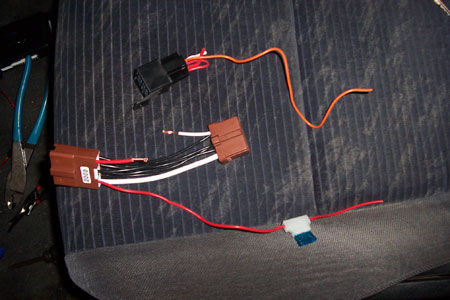

And do you have a part # for the "interconnect harness" that you mentioned you got from crutchfield? I searched, and couldn't find this for sale anywhere.

Nobody makes the interconnect harnesses any more that I know of. I prefer to de-pin the wire I'm tapping into, tap it directly at the pin, and re-pin it. Doesn't cost anything and it's pretty stealthy. I know I show it on several of the installs.
